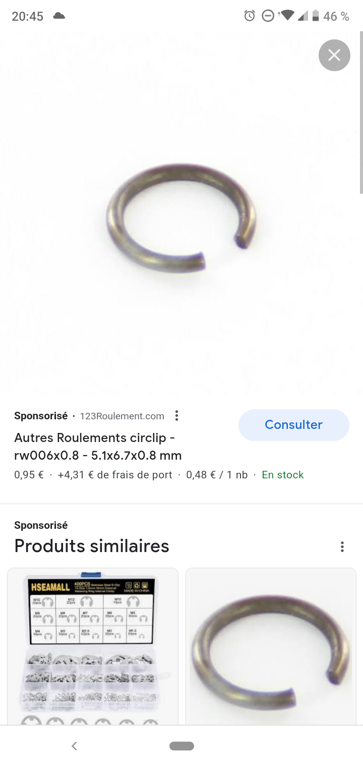

oops ive ordered normal clearance 6004.
can anyone tell me what part number 20188 looks like? would a circlip work?
and my box doesnt have part numbers 20181 and 20182. does anyone know the dimensions please?

Désolé sur ma SP98 c'est un montage différent
Cependant on dirait un circlip comme ça
Re: sp93 relay boite
merci
my shaft was 7mm and 6.3mm in the groove.
and part numbers 20181 and 20182?
i have found them both but the seal is perished. is it felt or rubber?
