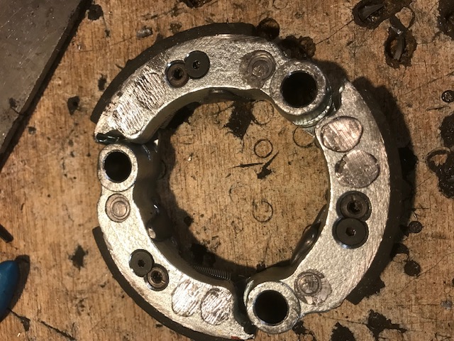

mon engagement er86 est trop élevé à 7750 tr/min. Je veux qu'il soit beaucoup plus bas, disons 5000 ou 6000 tr/min. j'ai un variateur er3.
Quelqu'un a-t-il réussi à modifier le er86 pour qu'il fonctionne à un régime inférieur?
J'ai essayé des ressorts beaucoup plus faibles. et ajouté du plomb aux bras. mais aucune différence. j'ai la version 2 bras. légèrement plus lourd.
J'ai remarqué que lorsque vous poussez un bras vers l'extérieur, le bras adjacent auquel il est attaché se déplace vers l'INTÉRIEUR. c'est peut-être pour ça qu'ils ne sont pas si bons. peut-être un point d'ancrage différent pour le ressort pour aider à faire pivoter le bras vers l'extérieur ?
Merci.
my er86 engagement is too high 7750 rpm. i want it to be much lower say 5000 or 6000rpm. i have a er3 variator.
has anyone successfully modified the er86 to work lower rpm?
i have tried much weaker springs. and added lead to the arms. but no difference. i have version 2 arms. slightly heavier.
i have noticed when you push one arm outwards the adjacent arm it is attached to moves INWARDS. maybe this is why they are not so good. maybe a different anchor point for the spring to help pivot the arm outwards?
thanks.

Hi you have to use softs springs and weigh clutch shoes down as you've already done, you did the right way, actually, that's weird that it doesn't works...

i will try more weight, drill holes and fill them with lead

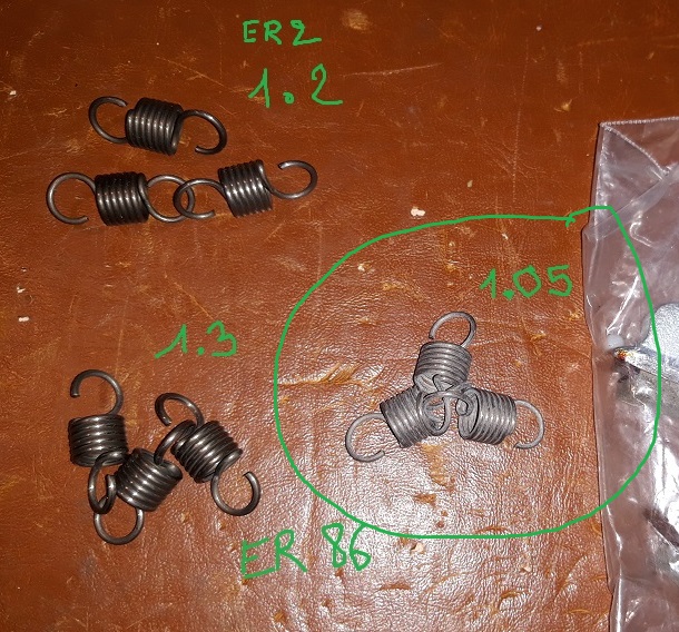

try OEM peugeot rcx spring, they're way weaker than doppler one's

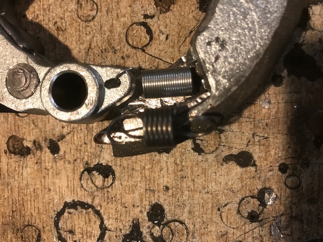

i have fitted some very weak springs 0.5mm wire.
am i going too weak?
ive drilled x 2 and filled with lead
if anything it engages higher?

yes i tried it and if anything it was worse? how is that? its a mobylette 50v 1974 but ive fitted an AV10 motor with a parmakit 50mm top end.
i am gonna try it with no springs, crazy but im running out of ideas. i think because the pulley/c;utch speed is so slow compared to the crankshaft there simply isnt enough centrifugal force for this to work below 7000 rpm.
my only other idea is to get the clutch arms relined so they are within half a mm of the bell. at the moment they are 2.5mm away. or i might slick some friction material to the bell
lol. or sandpaper.
maybe if i tried the er2 clutch arms fastened to the pulley. does the er2 have a lower rpm engagement point?
i see mir5 has replacement arms for the er86 only 16 euros. with thicker lining for better contact....
lol. or sandpaper.

my arms now weigh 170 grams each. i just tried it with NO springs at all. and the engagement point is exactly the same and the bell got very hot to touch.
do i have to run the friction material in? bed it in or break it in? i dont know if this will translate?
something is definitely wrong.

Hi, I didn't understand everything about the translation. If you can add photos it can help to understand each other.
Have you tried with Ø 1.05 mm wire springs?

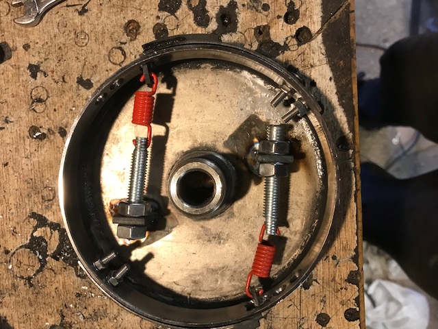

your arms are free on the axes? I think that you have a mechanical limit which prevents the good support on the bell.
Re: er86 fix
The shoe may not spin into the clutch (without springs), as David told you, check the clearance on your arm or anything else keep stuck?
Re: er86 fix
its all free i check that every time.
there was roughly 3 mm difference in bell diameter and diameter of the arms.
i have tried the springs that came with it (the weaker ones that were fitted.) they are 1.15mm ive tried 0.85 wire and 0.5mm wire. no difference.
i think it isnt spinning fast enough. not enough centrifugal force.
i think am going to have to increase the speed by fitting and mounting it on a smaller pulley.

i can move the arms well past the diameter of the bell. there is nothing stopping them moving outwards

maybe i need to run it for a while to get the lining worn to make better contact with the bell.
i will roughen up the bell and the lining and try and be gentle on the throttle for half a day to see if it improves.
maybe my weak springs are too weak?
thank you for all the help and advice so far

grease on shoe? did you try to clean with acetone? and sand papering the ferrodo?
Re: er86 fix
i use brake or carb cleaner whichever is closest. i have sanded the shoes twice

I looked at the photos again and saw that the lead was poured near the axes?
it won't really change the point of engagement.
to be effective the weight must be added away from the axes and you can't because the springs are inside the arms. the only way to decrease revs is to use softer springs. also check the gaskets and the bell (no oil, grease, paint, etc.)
and like my bro says: what about the sprints pre tensionning system inside each arms? did you tried to change it?
I do not see on the photos if the preload is at the minimum or not.

got to dash so this is quick.
can you not see the two holes filled with lead near the end of the arms?
preload at minimum and tried several springs from 1.2mm to 0.5mm wire.
going to clean everything and sand down and run for a while.

indeed, I looked too fast, i saw them but I thought they were foundry marks…

Oh shit ! Jaws sunk in the sand by the side of the road or what?
How ugly they are!

just like me and everything to do with me my bikes and even my wife.
ugly
i dont care what they look like. i just want them to work.
i will try bedding the linings in by running it gently then it it doesnt work i will persevere with this idea i borrowed off jbot on moped army forum

Sorry ? Calm down man, that was just a comment because I find it crazy that doppler made such a poorly finished product.

no it isnt doppler that made it ugly. its me!!
i drilled it and filled it with lead. that isnt bad casting. its my poor skills.
i was having a laugh saying everything is ugly. especially my wife. a light hearted comment?
this is the problem with literal translation. the meanings can get lost.
maybe in future i need to emphasise the meaning with an emoticon
